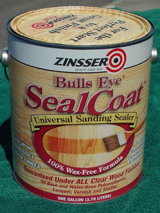

Home Depot and/or Lowes carries this:
I can't remember which store I bought it at, but one of them.

My local Lowes also carries the SealCoat.
However,After talking with my local self-owned hardware store guru, they now keep it in stock. So I buy it there.

Demand was not high enough to continue the product. Personally I did not like it because of the oil was in the mix. I do like Seal Coat as most know I have used it for years as both my sealing shellac and as shellac in most of my French polishing. I do get good shelf life but more like a year not Three.
